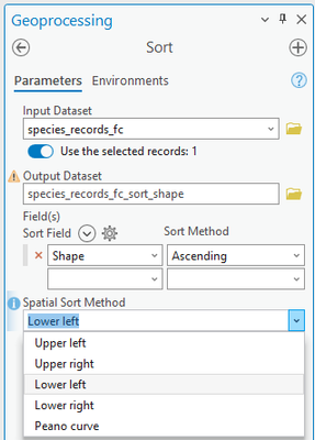

The documentation mentions that the Sort tool can be used to sort the SHAPE field:
Feature classes can be spatially reordered, or sorted. The Shape field must be used as the sort field for spatial sorting. There are a number of spatial sort methods that arrange the features differently based on their location.
What is the intended use case for sorting a SHAPE field?
And what does the tool do? For example, with points, does it sort on Y, then X, as if the X and Y were number fields in the attribute table?

Hello @Bud , does the Help page "How the Sort tool works" answer your What does the tool do question ?
https://pro.arcgis.com/en/pro-app/latest/tool-reference/data-management/how-sort-works.htm
For What is the use case, it also offers "Once sorted spatially, efficiency of spatial or geometric operations is enhanced."

The first 4 sorting options allow for directionality options
Upper left : sort from N-S, W-E
Upper right Sort from N-S, E-W
Lower left : sort from S-N, W-E
and Lower right:  sort from S-N, E-W
peano  reason given, plus the developer could implement it.
Missing options
radial sort from extent centroid
distance sort within the first 4 options
plus others
... sort of retired...
