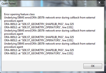

I want to create a spatial view that draws a buffer around my input features, like this:
SELECT
a.OBJECTID,
sde.st_buffer (a.SHAPE, 33) as SHAPE
FROM schemaname.tablename a
WHERE OBJECTID IS NOT NULL
I get the following errors:
Any ideas what the problem could be?
Geodatabase version 10.3; Oracle version 12.1.0.2. Configured according to this doc.

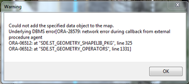

Thank you for your reply Asrujit. I found this Esri doc. that describes a configuration consideration with Oracle 12: http://support.esri.com/en/technical-article/000012391
Your test query (...from dual) works now. My view still fails with the same error, but I'm actually not sure anymore that Esri can create new geometries (e.g. buffer) via spatial views that I can then consume in ArcMap/ArcGIS Server.

I had to 'GRANT INHERENT PRIVILEGES ON ...' to get even your simple test query to work. Now I guess I have to look further....

Just to close this thread: it turned out that our libst_shapelib file was quite old. After we replaced it with a more recent one the error does not appear.
