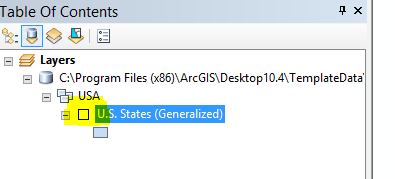

Did you turn-off the display for that layer before publishing the Service?
Anish_Adhikari
I did not. It was showing up on arcmap before publishing to server.
