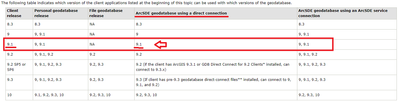

Problem 1:
  • ArcGIS Desktop 9.2/9.3/10.0 cannot connect to a Geodatabase 9.1 using "direct connect"
  • ArcGIS Desktop 9.1 can connect to a Geodatabase 9.1 using "direct connect"
  • this means you do not need the ArcSDE 9.1 Installer and you do not need to create the ArcSDE Service, you can simple use "direct connect" if you use ArcGIS Desktop 9.1
  • otherwise, if you use ArcGIS Desktop 9.2/9.3/10.0 you will need the ArcSDE Service 9.1 to be able to connect.
Desktop Help 10.0 - Client and geodatabase compatibility (arcgis.com)
ArcGIS Desktop Help 9.3 - Client and geodatabase compatibility (esri.com)
Old Help Documentation: Archive—Links to archived documentation for ArcGIS 10.2 and earlier
