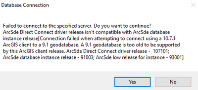

I have an SDE SQL database that has been somehow corrupted. I cannot connect to it from ArcGIS desktop anymore. It was 10.x something. I need help fixing this connection and if I can't somehow copy the data and design out of it and save it somewhere else.

I know I upgraded to 10.x from 9.1. Somehow something is wrong or got changed. Nothing happened to my other sde.

It is likely that the geodatabase you can connect to has been upgraded to a 10.x release. Geodatabase upgrades are separate from upgrading ArcMap and ArcGIS Pro, as well as SQL Server.
Are you able to connect directly to the SQL Server instance using SQL Server Management Studio? If you can, look for a table called sde_version and compare the contents between the database you can connect to, and the one you to which you cannot.
Newer ArcGIS clients cannot upgrade geodatabases that are at versions earlier than 10.1. Major changes were made to the structure of geodatabases at 10.0, and upgrades to 10.0 or later releases could only be done from a geodatabase that was upgraded to 9.3.
Do you have access to older versions of ArcSDE software? This is going to be the only way to get the 9.1 database upgraded to a point where it can either be seen from 10.x and Pro software, or upgraded to something that can be connected to.
This doc from 10.1 https://resources.arcgis.com/en/help/main/10.1/index.html#/A_quick_tour_of_enterprise_geodatabase_up...
outlines
You can upgrade ArcSDE 9.3, 9.3.1, or 10 geodatabases to geodatabase release 10.1. If your geodatabase is at a lower release, you must first upgrade to a supported release, then upgrade to 10.1.
Getting to 9.3 from 9.1 is going to require ArcSDE software - upgrades prior to 10.x were done using ArcSDE software, not Desktop applications like ArcMap.
