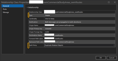

VanessaSimps
Along with that question, what if I have a unique ID (Key) field that isn't a GUID that I need to use? I have a polygon feature and a table that are both populated with data and a user defined unique ID that isn't a GUID for my key fields. Can I not use the duplication split policy now?
VanessaSimps
I was able to create this with a simple:
You have to have the GUID/GlobalID be the key and you have to change the Split Policy to Duplicate Related Objects.
