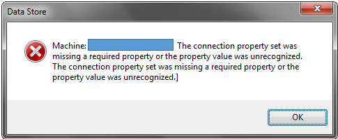

I am currently developing an web application for my client. The conditions are :
- Geodatabase and sde schema are on Postgresql 9.4 whereas ArcGIS server is 10.3
- Geodatabase is on different machine with the ArcGIS Server and both are linux
- Both are access-limited since both are stored in a data center
I have successfully created the sde schema on postgresql. However, when i registered it into server, an error popped-up as follows
My first guess is that arcgis server 10.3 does not support postgresql 9.4. Since i am a newbie in this kind of thing, i really beg for solution from you guys!! Help!!!!
Thanks before! Have a nice day

Your guess was spot on.
PostgreSQL database requirements for ArcGIS 10.3.x—Help | ArcGIS Desktop
Minimum supported database versions
PostgreSQL 9.3.5 (64 bit)
  • PostGIS 2.1
PostgreSQL 9.2.9 (64 bit)
  • PostGIS 2.0
PostgreSQL 9.1.14 (64 bit)
  • PostGIS 2.0

1. No, its the same for both Server and Desktop. If you check the bottom of this link ArcGIS Server 10.5 system requirements—Installation Guides (10.5) | ArcGIS Enterprise , it lists the supported databases. Those links state the same thing and directs you to the same page I provided earlier.
2. No, the links mention the Base version which is supported with that ArcGIS release.
Example: PostgreSQL 9.3.5 (64 bit)
This indicates that 9.3.1, 9.3.2, 9.3.3 & 9.3.4 are not supported at ArcGIS 10.3.x
However, versions higher than the base Supported version (in this case 9.3.5), that is, 9.3.6, 9.3.7 and so on are supported.

No, that "so on" was meant for any 9.3.x versions.
Whenever 9.4.x will be supported, it will be mentioned separately.
