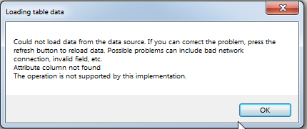

Hi,
This query works in PGAdmin and validates via the Edit query dialog in ArcGIS 10.5 however raises:
select *,ST_Z(Shape) AS "Height" from awsprod.lccgis.FLO_BUILDING_FLOOR_HEIGHTS
If I remove the all important ST_Z(Shape) AS "Height" the query works fine in the attributes.
Regards,
Richard

Placing the double-quotes around "Height" may have forced the SELECT result set to have a column named "Height", which ArcGIS cannot "see" because it requires ANSI-conformant SQL naming.  Try eliminating the double-quotes from the SELECT statement.
- V
RichardWebb2
Deactivated User
Without quotes of any kind this is working. Thanks Vince.
select *,ST_Z(Shape) as Height from awsprod.lccgis.FLO_BUILDING_FLOOR_HEIGHTS
