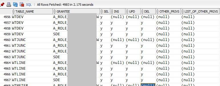

For anyone using Oracle, here's a post that uses a SQL query to list table privileges:How to audit table permissions as a non-DBA
select table_name, grantee , max(sel) sel, max(ins) ins , max(upd) upd, max(del) del, case when max(other_privs) is not null then 'other' end other_privs, listagg(other_privs,',') within group (order by other_privs) as list_of_other_privs from (select table_name, grantee, case when privilege='SELECT' then 'y' end sel, case when privilege='INSERT' then 'y' end ins, case when privilege='UPDATE' then 'y' end upd, case when privilege='DELETE' then 'y' end del, case when privilege not in ('SELECT', 'INSERT','UPDATE','DELETE') then privilege end other_privs from user_tab_privs ) group by table_name, grantee order by table_name, grantee
