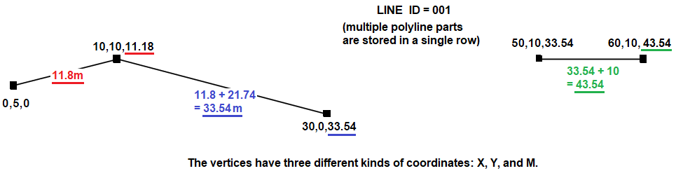

Input:
MULTILINESTRING M (( 0.0 5.0 -100000.0, 10.0 10.0 -100000.0, 30.0 0.0 -123),( 50.0 10.0 456, 60.0 10.0 789))
--select sde.st_astext(shape) from polylines
Output:
MULTILINESTRING M ((0 5 0, 10 10 11.18, 30 0 33.54),(50 10 33.54, 60 10 43.54))
--select m_as_length(shape) from polylines
