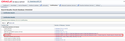

Question 1: Do these ESRI libraries only work with a certain LINUX Version, see list from Oracle below?
Question 2: Are there any other known issues which could arise in such a switch?
The following Linux x86-64 kernels are supported:
  • Oracle Linux 8.1 with the Unbreakable Enterprise Kernel 6: 5.4.17-2011.0.7.el8uek.x86_64 or later
    Oracle Linux 8 with the Red Hat Compatible kernel: 4.18.0-80.el8.x86_64 or later
  • Oracle Linux 7.4 with the Unbreakable Enterprise Kernel 4: 4.1.12-124.19.2.el7uek.x86_64 or later
    Oracle Linux 7.4 with the Unbreakable Enterprise Kernel 5: 4.14.35-1818.1.6.el7uek.x86_64 or later
    Oracle Linux 7.7 with the Unbreakable Enterprise Kernel 6: 5.4.17-2011.4.4.el7uek.x86_64 or later
    Oracle Linux 7.5 with the Red Hat Compatible Kernel: 3.10.0-862.11.6.el7.x86_64 or later
  • Red Hat Enterprise Linux 8: 4.18.0-80.el8.x86_64 or later
  • Red Hat Enterprise Linux 7.5: 3.10.0-862.11.6.el7.x86_64 or later
  • SUSE Linux Enterprise Server 15: 4.12.14-23-default or later
  • SUSE Linux Enterprise Server 12 SP3: 4.4.162-94.72-default or later

And Oracle 19c is certified by Oracle on the following Linux Versions
Oracle 19c on Linux x86-64
7 Versions (SLES 15, SLES 12, Red Hat Enterprise Linux 8, Red Hat Enterprise Linux 7, Oracle Linux 8.x, Oracle Linux 8, Oracle Linux 7)
