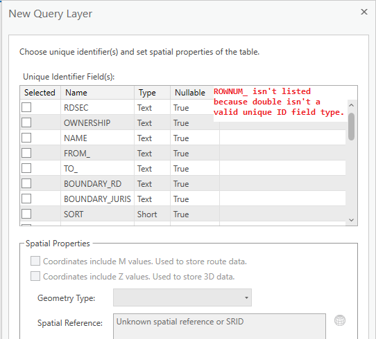

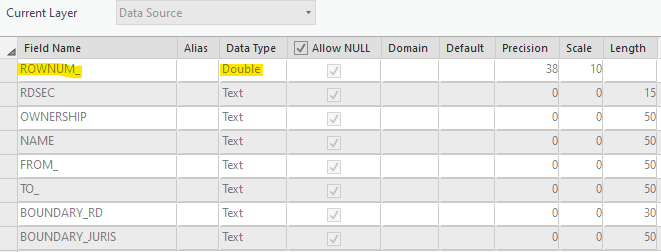

Regarding casting ROWNUM as an integer:
cast(rownum as int) as rownum_,
ArcGIS Pro is treating the ROWNUM_ column as a double:
So ROWNUM_ can't be used as the unique ID when dragging the view from Contents to the map:

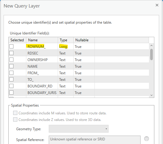

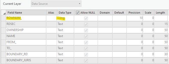

However, if I were to cast ROWNUM as a  number(38,0), then ArcGIS Pro would treat it as a long integer, which is good:
cast(rownum as number(38,0))
Question:
Why does Pro treat  cast(rownum as int)  as a double?
