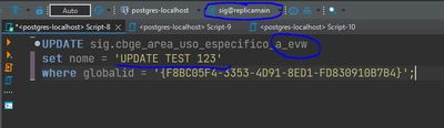

Using ArcGIS Pro 3.0.3 and PostgreSQL 12.4.
I'm running into an issue with a one-way replication in my Enterprise Geodatabase. I have a main geodatabase that sends data to the replica, and the replication works fine when I make edits using ArcGIS Pro. However, I'm having trouble executing SQL statements to update data from the _evw view, and the changes are not synchronizing with the replica.
I've checked my permissions and syntax, and everything seems to be in order. My changes reflects on the main database but not on the replica.
The Synchronize Changes tool works well but my data is not syncronized.
I'm editing the Default version of the data just using a simple SQL using an SQL client (dBeaver).
UPDATE myfeatureclass_evw SET my_field = 'XXX' WHERE [condition];

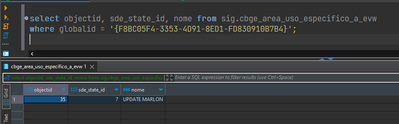

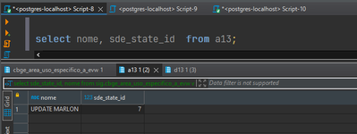

aricraimundo
Hi @MarlonAmaya
Yes, you are correct. The edits conducted in Pro are synced and with SQL aren't.
I've run a Compress now as you suggested but the result was the same.
Below are some screenshots from ArcGIS Pro and the query I'm running.
Thanks for you prompt response.

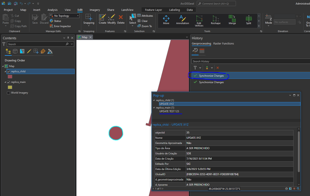

aricraimundo
Hi @MarlonAmaya
I ran the sync again using Pro and it worked (see image below).
I'm doing some tests in my machine. No other users involved.
I don't know what you mean about state_end_count. I'm sending queries after Compress+Sync.
Thanks again
