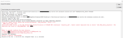

Then migrated the geodatabase into an Azure SQL Database using the Azure Data Migration Assistant , then ran the 10.8.1 upgrade geodatabase tool a second time (to update the stored procedures) but in doing so got the following error:
Could not update server tables and stored procedures. (sde_branches : Error (-37)
  DBMS error code: 2627
[Microsoft][ODBC Driver 11 for SQL Server][SQL Server]Violation of UNIQUE KEY constraint 'registry_uk2'. Cannot insert duplicate key in object 'sde.SDE_table_registry'. The duplicate key value is (SDE_BRANCHES, SDE, [database name]).
There is no further information in the log files referenced in the error. The geodatabase isn't versioned, though I did try a compress but that had no effect.
Is this a bug with the upgrade geodatabase tool using an Azure SQL Database or is there a permission or step that I am missing?
