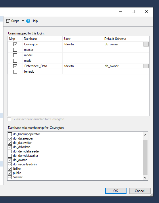

I'm using ArcGIS Pro 3.4.0. I need to re-version a feature dataset, and yesterday when I went to do this, I realized that I did not have the right server role to disconnect users, so I went into SSMS and changed myself to a sysadmin. I was already the database owner. Now, even though the option for DBO is still checked, it's telling me "User is not the data owner." Our address data is all null right now and cannot be edited because the feature dataset versioning is in a mixed state.

George_Thompson
Esri Notable Contributor
Questions:
  • Did you select all the permissions in the screenshot manually?
  • I would uncheck the db_owner permission on that DB.
  • Since you are SYSADMIN, you should have the correct permissions as you "mimic" the DBO user.
  • Just verifying that you have a DBO schema enterprise geodatabase?
    • i.e., all data is owned by DBO user.
A guess is that your UN / schema do not match and the mixed permissions are causing an issue.
--- George T.
TonyDevita1
Thanks for responding George. Yes, I selected them based on a document left by my predecessor. His document said to use gis as the schema, but after I started getting this error, I changed it to DBO because I was just running out of ideas on what to do. I even just tried setting up another database connection using my predecessor's login, and I still get the error message.
George_Thompson
Ok...... so the data is "owned" by the "GIS" user.
Using SYSADMIN will not allow you to take over the data, like an owner.
You will need to login to the EGDB as the GIS user in order to fix this issue.
I would back out all the permissions that you set based on the document provided to you. It is possible that the workflow worked in the past, but not now.

TonyDevita1
Thank you George. Taking off sysadmin did the trick. Ultimately, in order to accomplish both the disconnection of users and the re-versioning of the dataset, I need to use two separate database connections, one as the database owner and the other as the sysadmin. Then I was able to do what I needed.
