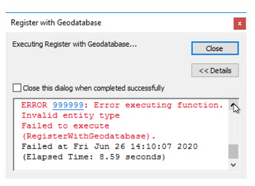

Hi,
I am working with ArcGIS 10.5.1 In ArcMap, I am trying to register a view with 'Register with Geodatabase' tool and it is failing with following error.
How can I find wrong 'entity records' from a view? resolve the view registration.

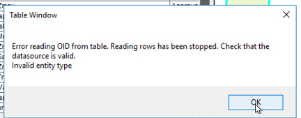

When I am trying to randomly zoom, navigate to feature in ArcMap. I get following error

Can you verify that it meets the following criteria for the view: Register a table or view with the geodatabase—ArcGIS Help | Documentation ?
--- George T.
