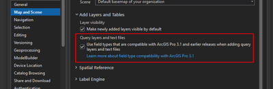

I just wanted to point out that I had to seek for a workaround and it wasn't enough setting the Use field types that are compatible with ArcGIS PRO 3.1 and earlier releases when adding query layers and text files option:cap1.png
Make sure that you cast your data to avoid high precision field types when creating the query layer. Example with a date type:
select objectid, CAST(data_modif AS TIMESTAMP(0)), shape from devdb.sde.centros_mp where objectid > 10
This way (tested in 3.2.2) I managed to publish without 00396 Error.
