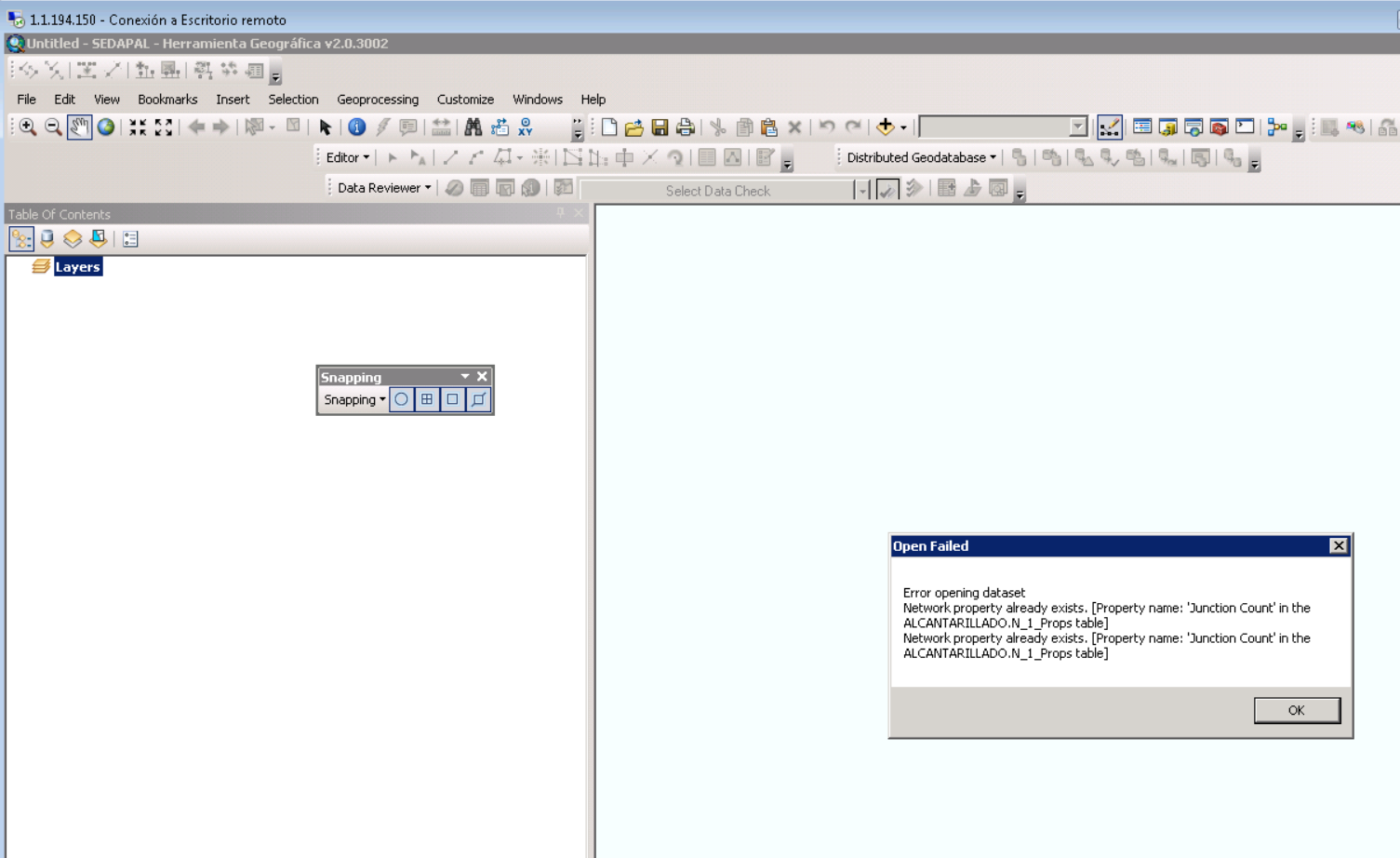

AmritaMundal1
Hi Asrujit SenGupta,
I am working on a case where the user is facing this error: Error opening dataset. Network Property already exists.He is working on ArcMap 10.3.1, Oracle 12C. Will re-granting the permissions help resolve the issue?
Any help will be highly appreciated!
Thanks,
Amrita Mundal.

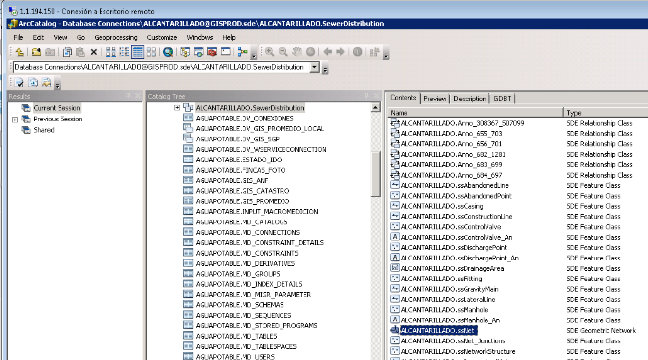

forestknutsen1
MVP Alum
Did you find a solution to this? We have an old database presting an identical error as yours, save the table name. I tried to add the network to a map while connected as the data owner and I still get the same error...
