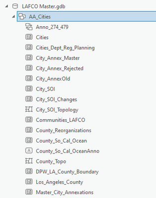

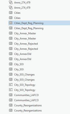

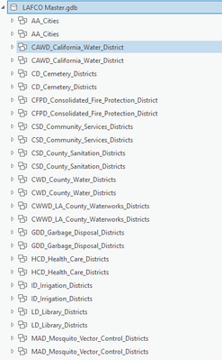

Long story short, I reprojected my data into WGS 84 without realizing they would be exported into the same master source gdb, deleted the duplicates, but now see ghost duplicates of feature datasets and feature classes of what I deleted when first opening ARC Pro.
Refreshing the geodatabase removes said ghosts, however, I am afraid that this problem will carry over to my data backup dataset and online data were I to update them.
Since then I deleted the duplicate feature dataset for all duplicates; however I still see the 'ghost' of the feature datasets below the real one. This seems to be an intermittent issue and goes away when I refresh my geodatabase.

You can try to create a new ArcGIS Pro document, then close Pro, open the new Pro document and try to open the File Geodatabase again. If this does not solve the issue then there is something funny with your File Geodatabase, I would create a new Empty File Geodatabase and copy the data from the old File Geodatabase to see if that fixes the issue.
