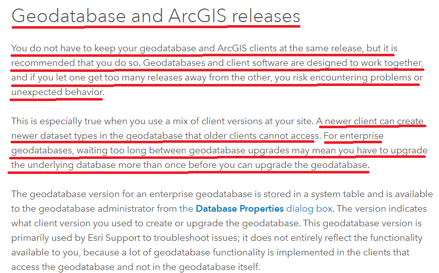

MarceloMarques
@anbinh
  • there are many changes in Pro 3.2 that Pro 2.9 cannot recognize
  • Pro 2.9 is old and cannot work with a geodatabase arcsde repository upgraded with Pro 3.2
  • a new version of Pro can connect and work with a geodatabase arcsde repository that is in a lower version
  • but an old version of Pro might find problems to connect and/or work with a geodatabase arcsde repository that was upgraded with a new version of Pro
  • therefore, users running Pro 2.9 will have to upgrade to Pro 3.2 to avoid unexpected behavior while accessing a geodatabase arcsde repository that was upgraded with Pro 3.2
  • read more below.
Client and geodatabase compatibility—ArcGIS Pro | Documentation
I hope this helps.

anbinh
Thanks all,
I confirmed with client that the version written in SDE_Version table has been upgraded to 11.2.
Thanks to Marcelo's screenshot, it is very likely due to their older version of ArcGIS Pro that they are seeing the wrong message. The documentation says "geodatabases and client software are designed to work together, and if you let one get too many releases away from the other, you risk encountering problems or unexpected behavior."
In my case, I will suggest client to upgrade their ArcGIS Pro to be able to see the right message.
