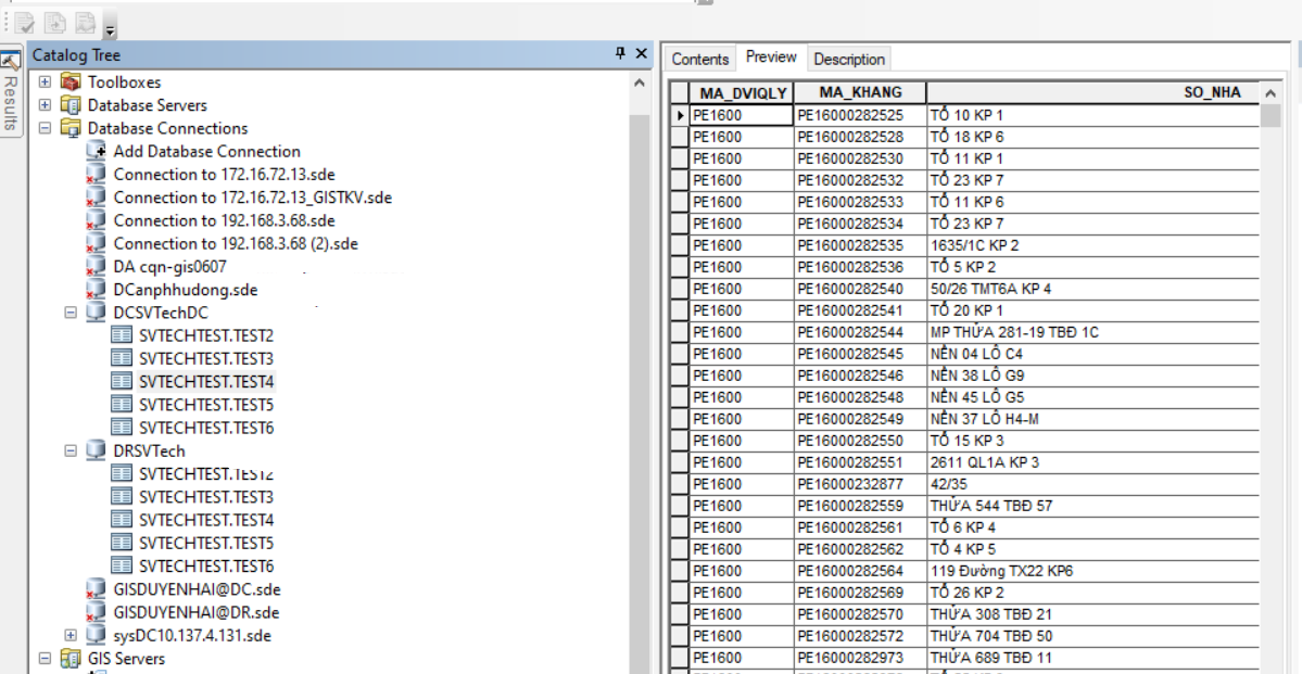

My Geodatabase is stored on DC (platform Oracle DB ver 12.0.1) and sync with DR (DC to full permission and DR just Read-Only). Now, I switch function between DC & DR (DC -> DR and DR -> DC). After switch, the data on still normal, but  when i use Arc Catalog create new "view" on new DC (DR old) i can not read it, but i can read on new DR (DC old), and on both DC DR i can not "register with Geodatabase".
Step 1: create "View" on new DC (DR old) but can not read it (i have Object ID).
create view in new DC (DR old) but can not read it.

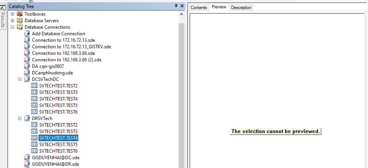

Step 2: I can read new "view" on new DR (DC old)
But can read on new DR (DC old)

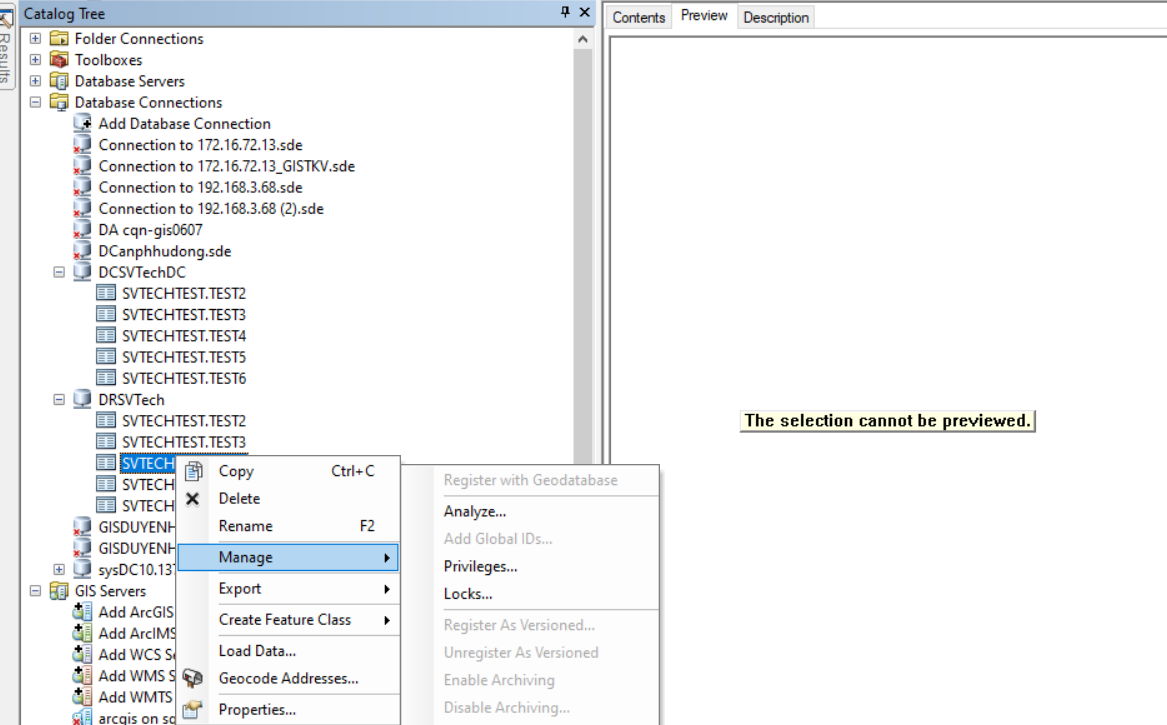

Step 3: Can not "Register with Geodatabase" on both DC & DR
and can not "register with Geodatabase" on both machine DC & DR
