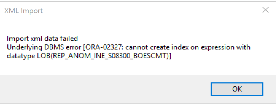

I have a File Geodatabase that contains Feature classes, Attribute tables, and relationship class.
I have exported all data as XML Workspace so I can import the data into an Oracle Geodatabase Enterprise ( Oracle version: Oracle 12c R2 (64 bit) 12.2.0.1 ).
When I try to import XML Workspace document I receive this error
Any help please to fix this error and load data?
Thanks
RexRobichaux2
Hi DEV APP,
    Have you been able to identify the field which is getting created as a type LOB? Chances are upon XML import its trying to create this table in a tablespace and encountering the ORA-02327 error. As it indicated, you cannot move or rebuild an index on a LOB datatype in another tablespace.
Oracle DBA: How to rebuild a LOB Index in oracle
   Therefore, I'd suggest changing the column datatype, or using an import / load method that won't automatically try to create an index on this field. You could try running the feature class to feature class GP tool, or creating a schema only table in Oracle mapped from the schema of the source table, and then load data for this particular feature class. I hope this is helpful!
