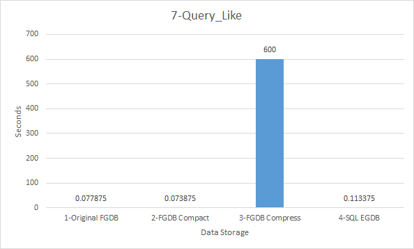

A File Geodatabase (FGDB) that has been compressed has showed to perform better on almost all operations tested, except a query with the LIKE operator (using _).
The underlying field where the LIKE operator is applied to is indexed.
Does anyone have ideas how to increase query performance on a compressed geodatabase when using a LIKE operator?

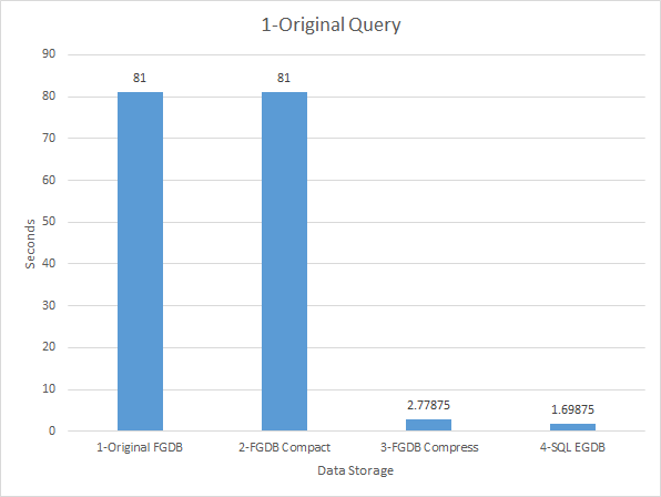

What we observe is that some clients are making requests like this 1K record chunks at a time.  Some of the clients are throwing upwards of 16 concurrent requests at the server and the server takes over 80 seconds to handle EACH request with the uncompressed database. This set of requests cause high CPU on the back-end arcgis server environments and if left unchecked, cause system unresponsiveness on this and many other services co-located here (the environment gets 5-6M hits a day with 60K+ unique clients). The back-end hardware is generally enough to handle daily operations (4 servers, each with 8 CPU, 32GB RAM), but when this scraping action occurs we experience instability. We have had to selectivly deny public IP addresses that exhibit this behavior.  Often times they will come back, but scale back the concurrent requests (to like 😎 which the systems are able to handle, albeit a bit slow.  Some of these are public anonymous users.  Sadly, we do have the data available for download but cannot seem to prevent public users from scraping the data as a service.
When we compress the FGDB (reduces to 3.5GB), the same request only takes 2.78 Seconds and a SQL Enterprise GDB takes even less at 1.7 seconds:

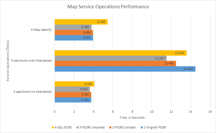

Naturally the SQL Server Enterprise Geodatabase (EGDB) hosting appears to be the best case to resolve this performance issue, however we have completed some extensive testing and the FGDB hosting beats out the EGDB hosting on many other operations:
The tests noted above were doing simple operations within a web-map (and using fiddler to reissue the requests sequentially a few times to obtain the response times).  As you can see, the SQL EGDB performs worse than the compressed FGDB (the FGDB is 13-43% faster depending on the operation).  We have completed similar tests on other datasets and generally publish from a FGDB due to the performance gains.  This back-end EGDB was fully compressed (state of 0) with no versioning.  And the dataset is heavily indexed on both FGDB and EGDB.
So far, everything points to using a compressed FGDB for performance gains, however a query using the LIKE operation takes so long it times out

In terms of the performance you are seeing with LIKE, the first thing that comes to mind is your LIKE statement isn't fully utilizing an index.  The structure of a LIKE statement can greatly impact how an index is used.  If an index isn't being used, or used very much, a compressed file geodatabase would require the data to be uncompressed before comparing the data with the search criteria.  The process of uncompressing the data could add significant time to queries.
