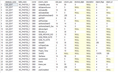

@VinceAngelo Hi Vince, we've found this post quite interesting and have ran your query above and it seemed to work, however when we then check the table in catalog it is still set to allow null values. We then viewed the sde_column_registry table and can't see where the allow/not allow nulls is referenced? In screen shot it is the CreatedBy_temp field that we ran the ALTER TABLE query on.
VinceAngelo
Esri Esteemed Contributor
Changes made to the base table are not manifested to SDE table metadata immediately. You must first connect as the owner and describe the table (this can only be done as the owner).
You do not want to do this if the table is registered as versioned.
- V
