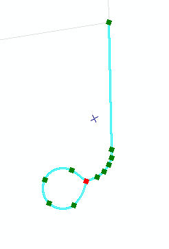

I don't want to select lines that close in on themselves midway like this:
I tested ST_IsClosed  and ST_IsRing. Both of the lines in the screenshots above were identified as closed and as rings. So it's not clear to me what the difference between the two functions is.

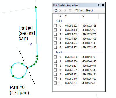

It turns out the cul-de-sac in the second example is actually a multi-part feature:
Bud
Legendary Contributor
I think the answer is: I should be using isRing. The word "Ring" is self-explanatory.
I was originally thrown off by the fact that some of my lines are multi-parts. So, an individual part could technically be a ring, even though the feature as a whole didn't appear to be a ring.
So, both of my example features were being identified as closed and as rings (my query only looked at the first part of multi-part features; in my examples, the first part was a ring).
