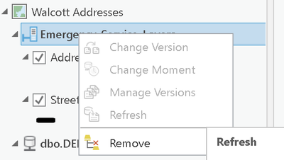

I have been using branch versioning for a while for my parcel fabric.  And now I wanted to use this sort of feature service for more of my data layers.  I have a SQL server database, and have successfully created a database connection, with a geodatabase connection type of "branch versioning."  And I have been able to actually edit using the feature service that I created.  My only problem is that I cannot seem to change from the default version and create any additional versions.  When I right click on the data tab to try to manage the versions, it is grayed out.  See below:

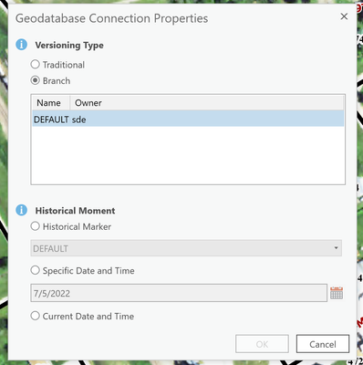

When I go to the connection properties, this is what I show:

Did you enable the Version Management Server (VMS) when you shared the service?
https://pro.arcgis.com/en/pro-app/latest/help/data/geodatabases/overview/publish-branch-versioned-da...
I did this same thing and determined I forgot to enable the VMS on the service.
--- George T.

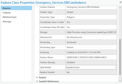

If you open one of the feature class properties from the Enterprise Geodatabase, what are the properties for versioning in the dialog?
It sounds like the data is not properly configured for branch versioned.
--- George T.
Syvertson
It says versioned.  And the connection says versioned.  And it lets me edit, but does not allow me to create or change versions.  I am going to try copying the dataset to a database that is already working in branch and see if that works there...
