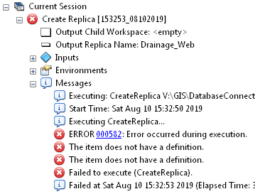

Hello,
I am having a problem creating a replica in an enterprise geodatabase. We are running 10.6.1 and running on SQL Server. I have had this dataset as a replica, but recently deleted the replica and the dataset from the geodatabase replicating to. The replica supports two replication and is from one geodatabase to another. The error message I am getting when creating the new replica is Error 000582: Error occurred during execution. ArcToolbox also says under the error message: "The item does not have a definition". Here's a screenshot from ArcToolbox:
Has anyone had this error message below and know what "the item does not have a definition" means?
Thanks in advance for the help.
Nick

It looks like you may have an orphaned replica version in your database.  The Create Replica tool is looking for a replica that does not exist.
Take a look at How To: Determine if there are orphaned replica system versions in the geodatabase
