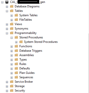

What is the name DB being created?
Is the DB set up as DBO or as SDE schema?

Can you provide a screenshot of the empty database and any tables that are created after it fails?
