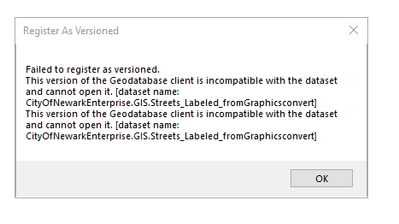

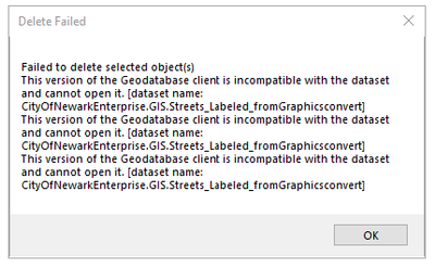

Hello.  I thought I was performing a simple Copy Features from a FGDB in Pro into a versioned feature class on our enterprise GDB, which succeeded.  When I went to register the feature dataset as versioned, I received the following versioning error.  I tried to delete the new feature class and received the following delete error.  This all started by converting the labels from an enterprise feature class to graphics in a Pro project.  I then edited the label graphics, then converted them back to features (Graphics to Features), then used the Copy Features to create the new FC in the feature dataset on our enterprise GDB sde, for others to use as needed.  I am not sure what I can do next.  I have server management studio but I hesitate to delete from there.  Any help would be appreciated.

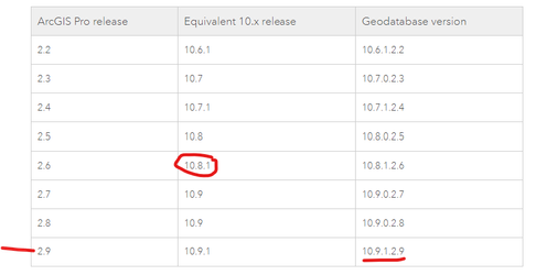

Sounds like your ArcGIS Pro version might be out of step with your geodatabase version:
Client and geodatabase compatibility—ArcGIS Pro | Documentation

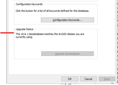

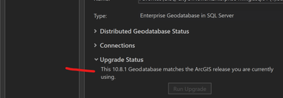

In ArcCatalog, I can see our GDB is version 10.8.1, and the message says it matches our current ArcGIS release.  I am assuming this is referring to ArcMap (at 10.8.1)?    In reviewing the online documentation link you provided, it suggests our Pro versions are well ahead of our geodatabase version (second screen shot).  We are using Pro 2.9.2.  We updated our Pro users last week.  The 'graphics to feature' work I did yesterday, after the upgrade.  Just prior to the Pro upgrade last week, I did some similar Copy Feature work from Pro to our sde, into the same feature dataset, and had none of the issues I see now.  This has me wondering if the new Pro version is now too "new" to write new feature classes to sde from Pro, and we are now past the backward compatibility "window?"  I don't quite follow the SSMS steps you suggested to check the GDB version.  However, when I check the version in Pro, I get the same message as with Catalog, and the prompt to upgrade is greyed out.  I am not sure what is next to try, Esri support ticket?  Any further help is greatly appreciated.  Thank you.

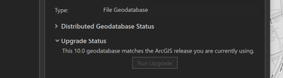

My FGDB created in the Pro project has this version.
