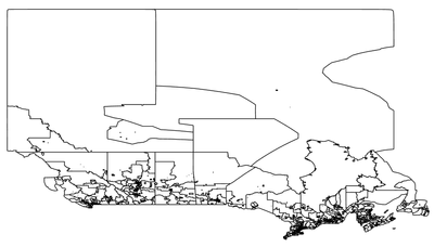

SaurabhUpadhyaya
Hi,
I tried first option Project(Data Management) to change the projection system.
In Existing Data coordinate system is NAD83/Statistics Canada Lambert Coordinate reference system and i want to change it into EPSG 4326, after changing the coordinates its shape change.
This is the actual data of canada FSA, (NAD83/Statistics Canada Lambert Coordinate reference system)
After applying EPSG:4326 it becomes this shape.
DanPatterson
MVP Esteemed Contributor
Don't use the cartographic version, and add extra vertices to preserve shape during the projection
The above is a plain wgs84 version of the lambert
