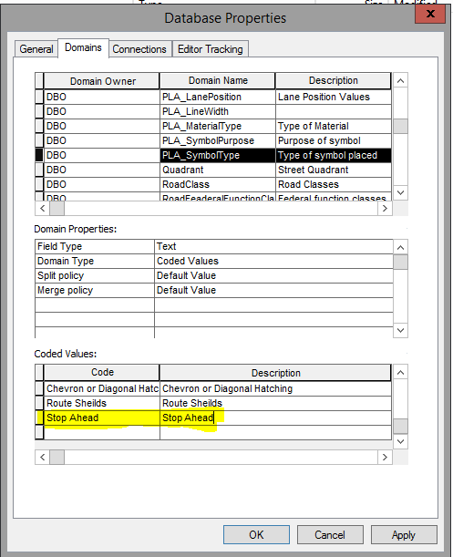

Add a new coded value, it is there and everything appears fine.
Apply and refresh the database, value is still present.
Close and reopen ArcCatalog, open the database and the value is gone.

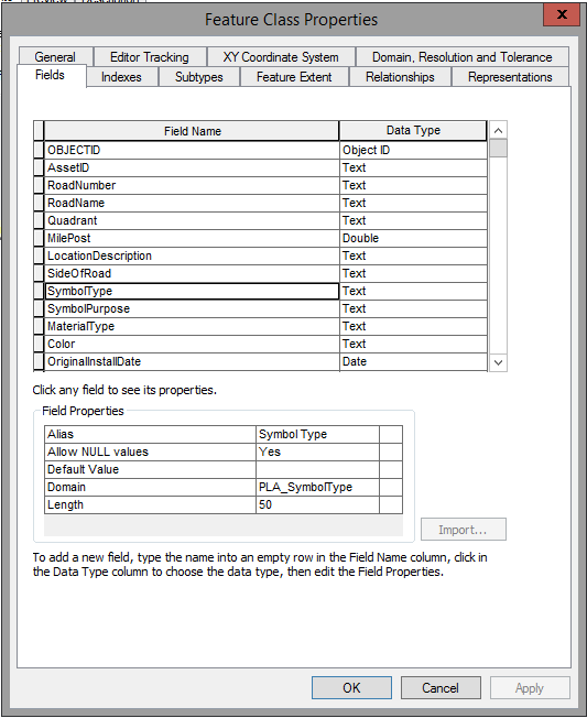

There are no Subtypes, the domain is correctly connected to the field and all the existing codes work correctly.
I am owner and DBA for the database and this same layer happens to be in one of the other databases I manage. The domain applied correctly and with no problems in that database.
