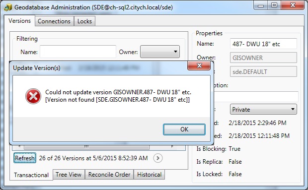

My assistant made some project versions of our main sde geodatabase and unwittingly used double quote characters in their names, which is apparently an sql no-no. If I go through version manager and try to delete the version using sde superuser, nothing happens. If I try modifying the name or access, I get this error:
I don't have access to the sql server to manually dig through that way, and I'm not sure what to tell the IT manager to look for.
Any ideas how to remove these "ghost" versions?

NIM037586 - Cannot create/delete a version containing quotes...
You will have to delete the version from the database end, considering all the factors (the version having quote in it's name, a space being present just after the quotes, etc).
** Take a database backup, make sure all the edits from that version has been Reconciled\Posted and then ask the DBA to delete that version from the 'versions' table at the database end.
