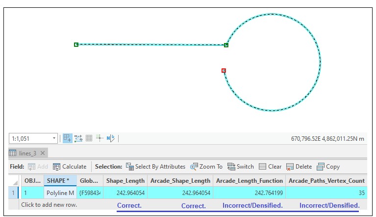

Side note for anyone who’s interested:
Arcade automatically pre-densifies true curves. So that affects the Arcade length too (Length($feature))…the Arcade pre-densified length will be different than the real length.
Whereas the Shape length ($feature.shape_length) doesn’t get pre-densified, at least not in SDE.ST_GEOMETRY in Oracle.
