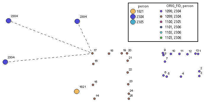

Since I also create lines between the point and "line" features this help to check the result:
The larger points are the original points (houses) and the smaller points are those that represent the streets. The dashed lines connect the house to the nearest street point.

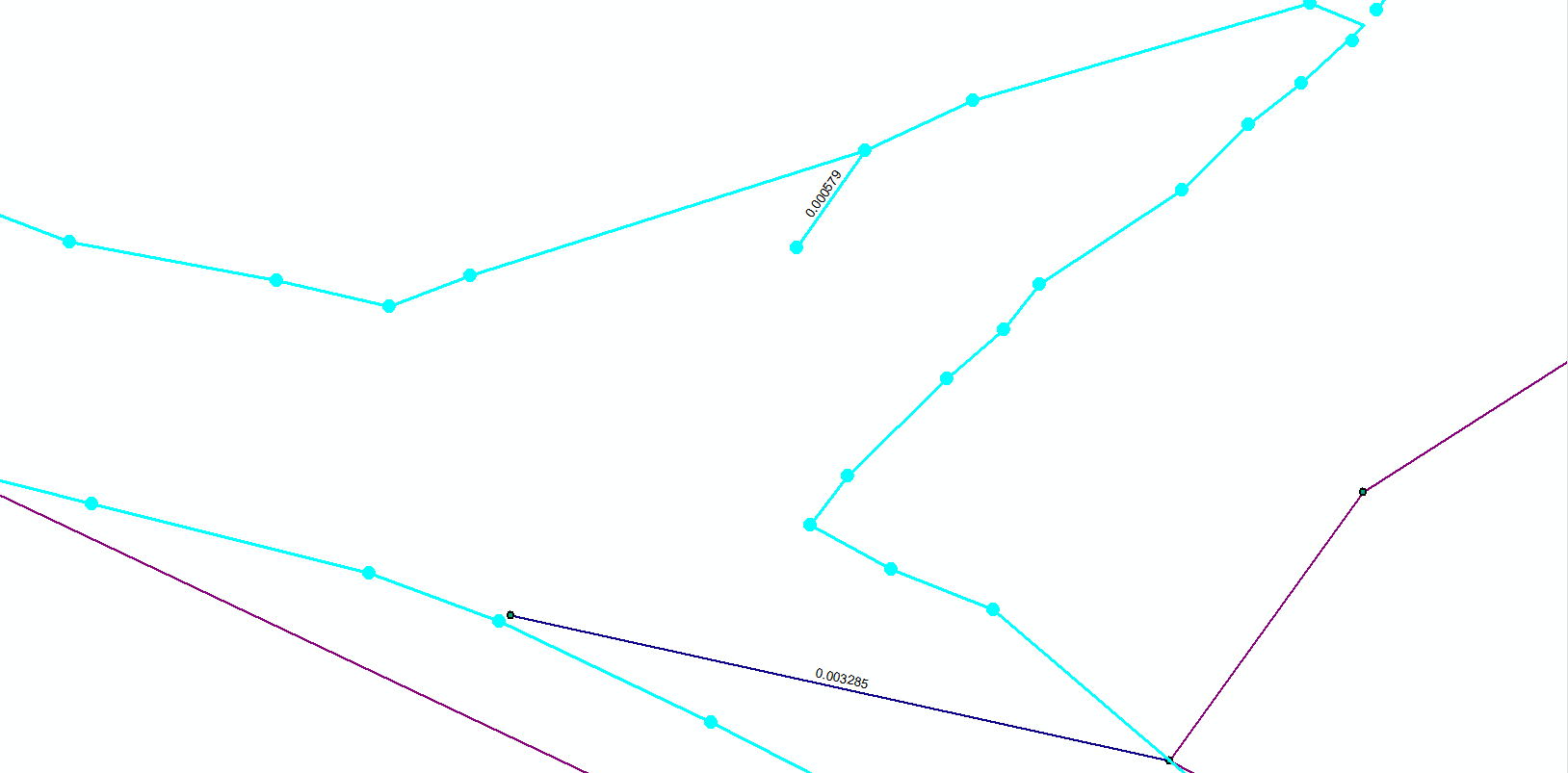

example for distance calculation
Is there an easy way you would think of to manipulate your script in order to calculate the nearest distance to the line? I have uploaded a picture (above) to illustrate what I mean (look at the distance in the upper middle [0.000579]).
Let me know what you think. Thanks a lot,
Christoph

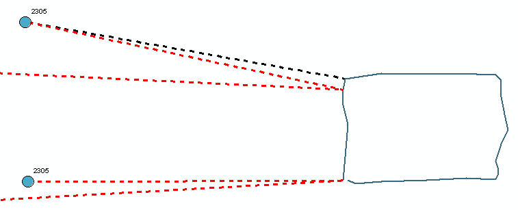

Example result (in red the new connections)
