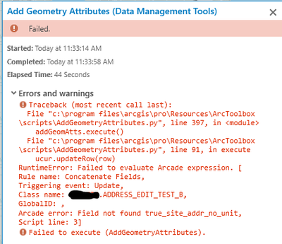

But then I tried to add calculate geometry tool and add geometry attribute tool manual. I got both same error.

Was there an actual fix for this? I get the Traceback issue as well, but my lines of code for py. are different. I figured if you had something then maybe I could look into it.
