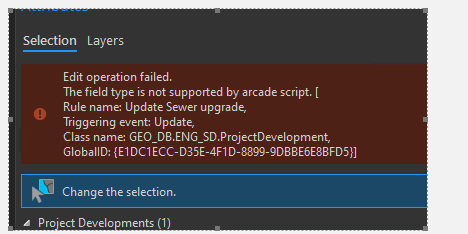

While there are no validation errors, ArcGIS Pro comes up with following error during testing:
Any help in resolving the issue will be appreciated.

According to the documentation of the attribute rule dicitonary keywords ,
  • the "result" field in the returned dictionary is either
    • a value for the field definied as return field for the rule
    • a dicitionary for the geometry and/or attributes of the feature, if you haven't set a return field in the rule
  • You return a log message. If you haven't set a text field as output field of the rule, this should throw an error.
  • The ObjectID in the update array should be given in the dictionary field "objectID", not "OBJECTID", don't know if this would cause an error, though.
So, try this:
//s1 - get all the features from sewer upgrades feature class
// you only need DBNUMBER (to filter) and OBJECTID (to send edits)
var destination = FeatureSetByName($datastore, "GEO_DB.ENG_SD.SewerUpgrade", ["DBNUMBER","OBJECTID"], false);
//s2 - get dbnumber edited in the projects developments feature class
var dbnumber = $feature.DBNUMBER;
//s3 - filter feature based on the existing edit
var match = Filter(destination, "DBNUMBER = @dbnumber");
//s4 - update records in sewer upgrades
var sewerupgradelist = [];
var counter = 0;
for (var feature in match)  {
    sewerupgradelist[counter] = {
        'objectID' : feature.OBJECTID,
        'attributes' : {
            'CONS_ST' : $feature.CONS_ST,
            'CONS_ED' : $feature.CONS_ED,
            'EST_CON_DUR' : $feature.EST_CONS_DUR,
            'TECH_REV' : $feature.TECH_REV,
            'STATUS' : $feature.STATUS
    counter++
return {
// only use this if you have set a text field as return field for the rule
//    'result' : numfeatures + ' sewer upgrades features found.',
    'edit' : [{
        'className' :  "GEO_DB.ENG_SD.SewerUpgrade",
        'updates' :   sewerupgradelist
Have a great day!
Johannes

Raj-Chavada
Thank you so much! This worked. Accepting as solution.
