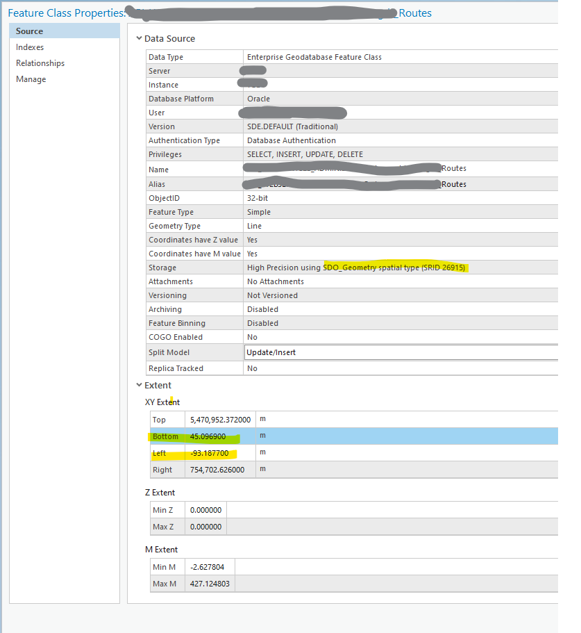

A feature class in our enterprise geodatabase seems to have an extent with inconsistent coordinates. See attached image.   It appears that the lower left bounding coordinates are in unprojected/lat long coordinates when the feature class should be stored in 26915 NAD 83 15N.   The upper right coordinates look appropriate.
What could cause this?
VinceAngelo
Esri Esteemed Contributor
Loading incorrectly projected data would certainly cause this, even if it was then deleted.
You should do a search for data in the range {-180,-90,+180,+90} to make sure improper data is not present, then you can reset the envelope of the dataset.

Now I see that I mistakenly thought that they show up in the correct location.  Some of the bad records are technically multipart features where one part is correct.  This confused me in ArcPro.
Not sure how these were created but at some point someone created the records in the correct location only with the lat/long coordinates.   Then later they appear to have tried to correct them but instead created multipart features where the first part has the erroneous lat/long and the second part has correct utm coordinates.  They are all overlapping.

VinceAngelo
That makes more sense. You should be able to use SQL to update the lat/lon geometry component, if you just isolate the lat/lon coords and project them.
