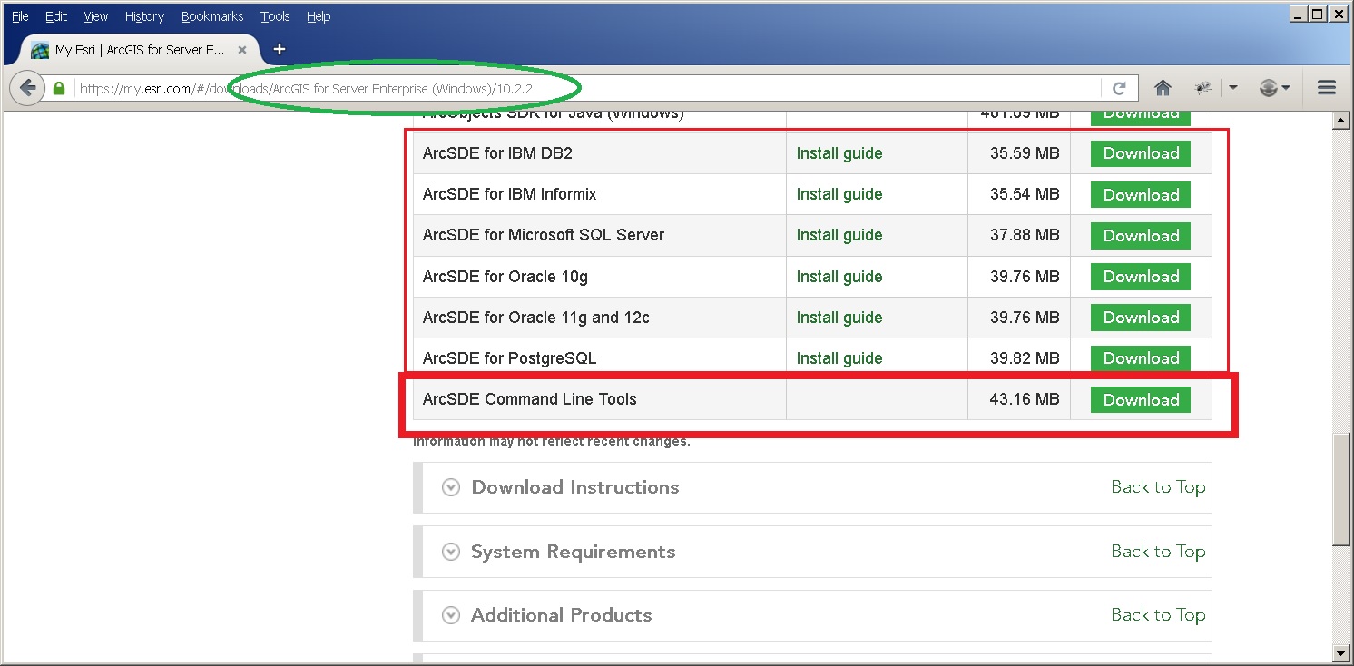

The SDE command line tools is a separate installation. You can download them from the MyEsri site by navigating to My Organization > Downloads > ArcGIS for Server Enterprise > View Downloads

No, Personal and Workgroup geodatabases are only accessed through ArcObjects (Desktop/Server).
You need to download the "ArcSDE Command Line Tools" or the appropriate enterprise application server install to obtain command-line tools. You must obtain these from the 10.2.2 "ArcGIS for Server Enterprise (Windows)" media bundle at my.esri.com.
