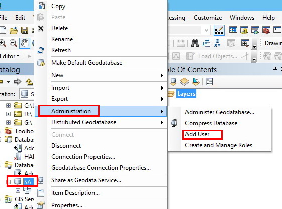

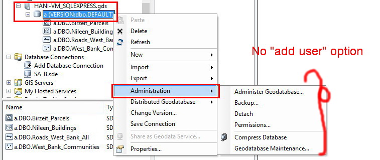

I am not able to find how can I add a user to a workgroup geodatabase, as I do in an enterprise geodatabase (right click the geodatabase connection>administration>add user) as shown in the first screen shot. However there is no “add user” option in the administration options for a workgroup GDB created with Microsoft SQL Server Express and added to the geodatabase server (shown in the second screenshot)
Any help is highly appreciated
1- Adding a new user to an enterprise geodatabase
2- How can I add a new user to the workgroup geodatabase?

That will not work. The users should be a part of the same Domain when you are trying to add them to an Instance.
In your case, your PC seems to be a standalone PC on a network. It is not associated to any Domain.

You need to Right Click on the instance connection first> Permissions> Add the login to the instance first
Then Right Click on the geodatabase> Administration> Permissions> Add the login to that geodatabase and grant necessary permissions

I tried this and it worked with different users in the same machine (for example: hani-pc\hani, hani-pc\ahmed, and hani-pc\sami). However when adding users from other machines within the same network (for example: Asrujit-pc\Asrujit), I got the following error: "windows nt user or group not found. check the name again"
How can I resolve this problem?
Once again, Thank you for the prompt answer!
