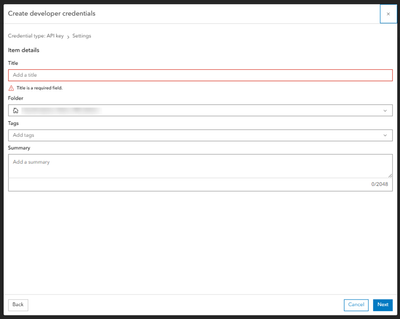

  3. Give the API key a unique title (e.g., based on the user or group that will be assigned the API key) and optionally fill out the other settings, then click the “next” button.

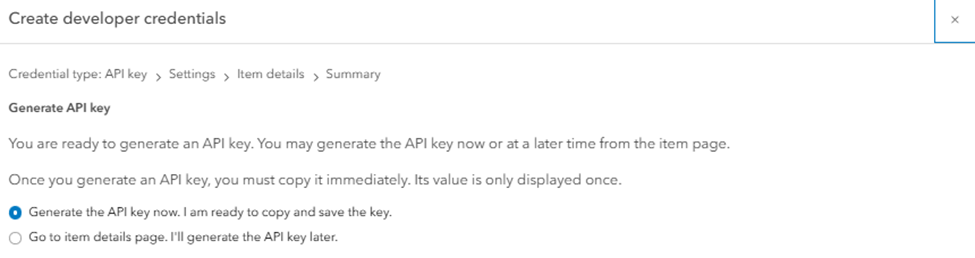

  5. An option will be provided to generate the API key now or later. Select an option and click the "next" button.
    Note: Once the API key is generated, it must be copied immediately to a secure location, given that it is not stored for future access. Following the API key security best practices will help keep the API key secure.

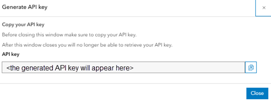

  6. If the option to generate the API key “now” was selected, the API key will appear in a new pop-up window. This API key is used to authorize GeoAnalytics for Fabric. As noted in step 5 above, following the security best practices will help keep the API key secure.

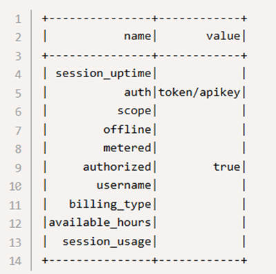

To verify that GeoAnalytics for Fabric was authorized successfully, use geoanalytics_fabric.auth_info()
geoanalytics_fabric.auth_info().show()
If the authorization is successful, this will return a table containing the GeoAnalytics for Fabric authorization information. When using an API key, the "auth" row will have a value of "token/apikey". For demo purposes, the other row values that would normally be returned in the table were left blank.

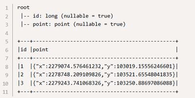

df = spark.createDataFrame(data, ["id", "point"]) \
          .withColumn("point", ST.srid("point", 6558))
df.printSchema()
df.show(truncate=False)

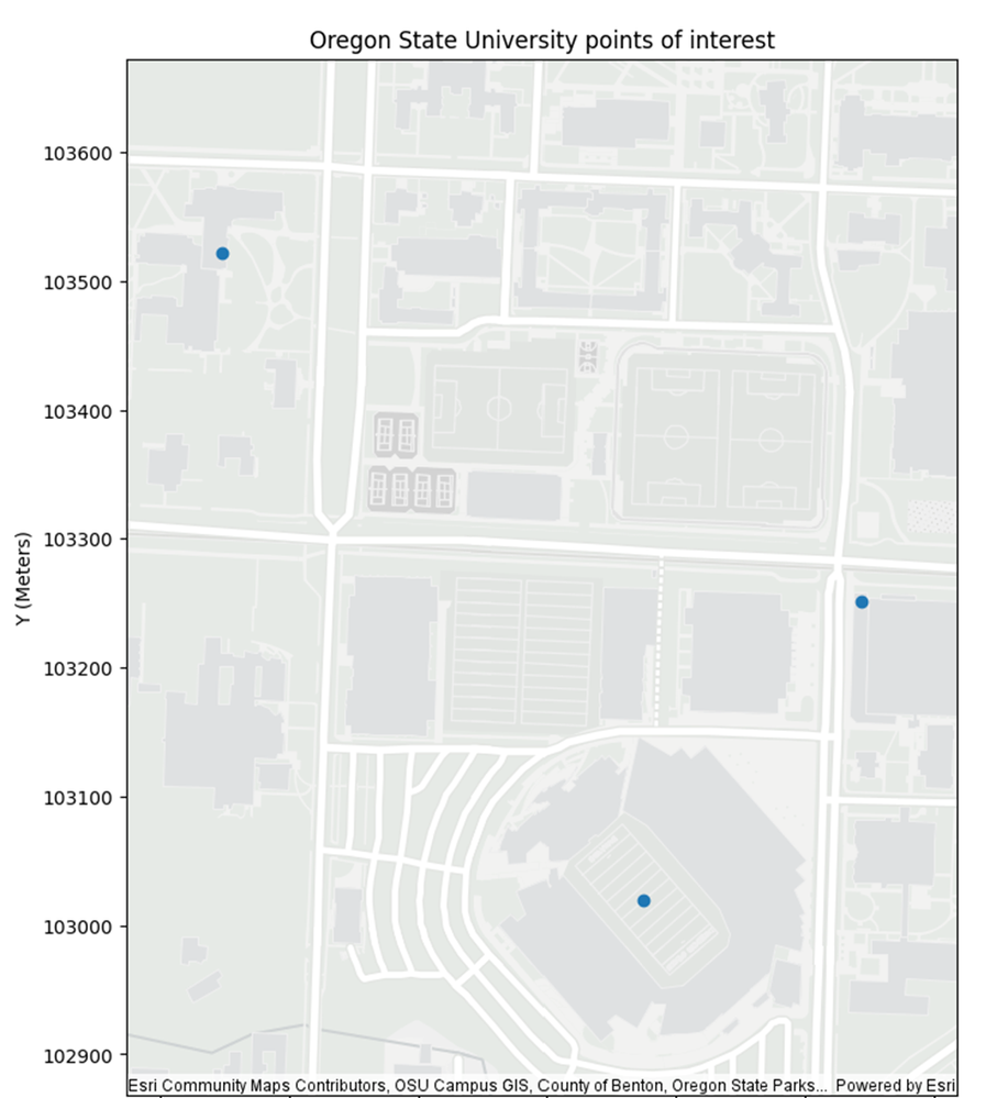

# Plot the DataFrame
df_plot = df.st.plot(basemap="light", xmargin=0.15, ymargin=0.3, figsize=(10,10));
df_plot.set_title("Oregon State University points of interest")
df_plot.set_xlabel("X (Meters)")
df_plot.set_ylabel("Y (Meters)");
