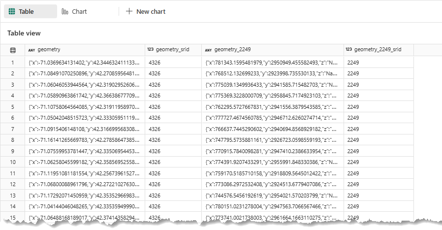

# Transform geometry using ST_transform and check the SRID values
display(df
    .select(
        "geometry",
        ST.srid("geometry").alias("geometry_srid"),
        ST.transform("geometry", 2249).alias("geometry_2249"),
        ST.srid("geometry_2249").alias("geometry_2249_srid"),
When we look at the results, it's clear that the coordinates are very different for our geometry and geometry_2249 columns. geometry is using latitude and longitude in WGS84 and geometry_2249 is using the Massachusetts State Plane Coordinate System in feet.
