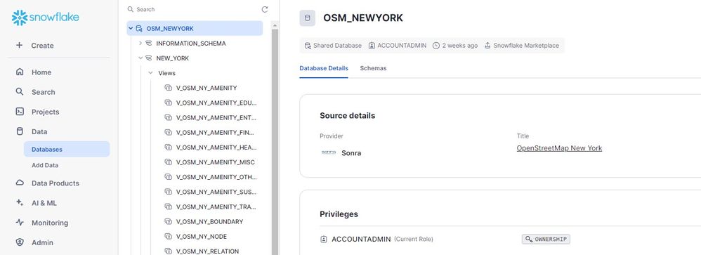

For this example, I’m working with Open Street Map (OSM) data stored in Snowflake.  Setting up some sample spatial OSM data is described in the Getting Started with Geospatial – Geography quickstart from Snowflake.
From this quickstart, I set up a database with a variety of OSM data provided by Sonra.
Database with tables of Open Street Map (OSM) data with geographic coordinates in SnowflakeDatabase with tables of Open Street Map (OSM) data with geographic coordinates in Snowflake

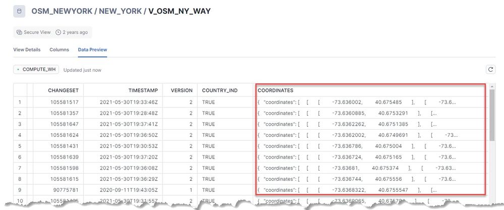

You can find more detail on the Snowflake Geospatial data types in the documentation linked here.  In general, you’ll often see the data represented as a GeoJSON string, but Snowflake also supports Well-Known Text (WKT), Well-Known Binary (WKB), and Extended WKT and WKB
In the data table, the geography appears as GeoJSON strings:
Geographic coordinates in a GeoJSON format in a Snowflake tableGeographic coordinates in a GeoJSON format in a Snowflake table
Since GeoJSON is a format that can be input with GeoAnalytics Engine it becomes straightforward to work with the data.

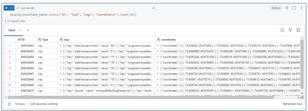

After the initial read of the data from Snowflake, we have access to our data in the table as a dataframe in Databricks.  In the case of this dataset, we are looking at about 5.7 million records with a variety of attributes, including the GeoJSON strings for the geography coordinates.

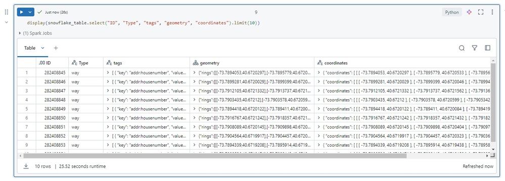

Geographic coordinates in GeoJSON format after being read into a dataframe in DatabricksGeographic coordinates in GeoJSON format after being read into a dataframe in Databricks
Now that we have connected to our data, we just need to convert the coordinates from a GeoJSON string into a geometry type for work with GeoAnalytics Engine.  To do this, we just need the ST_GeomFromGeoJSON function.  In this example, I’m adding a new column to hold our geometry and specifying that the coordinate system for the data is WGS84 (SRID 4326):
snowflake_table = snowflake_table\
    .withColumn("geometry", ST.geom_from_geojson("coordinates", 4326))
After adding that column, we now have both a GeoJSON string (“coordinates”) and a geometry (“geometry”) that we can work with directly with GeoAnalytics Engine.
Geographic coordinates from a Snowflake table in GeoJSON format and as geometry when converted with GeoAnalytics EngineGeographic coordinates from a Snowflake table in GeoJSON format and as geometry when converted with GeoAnalytics Engine

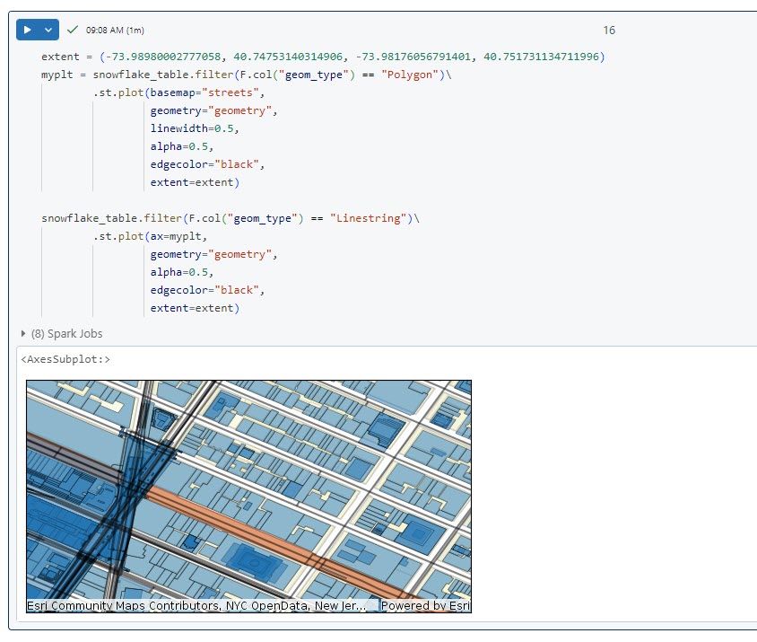

We can also plot the results to look at the data visually.  Since this particular dataset includes Linestrings and Polygons, we can separate those out to plot independently.
extent = (-73.98980002777058, 40.74753140314906, -73.98176056791401, 40.751731134711996)
myplt = snowflake_table.filter(F.col("geom_type") == "Polygon")\
        .st.plot(basemap="streets",
                 geometry="geometry",
                 linewidth=0.5,
                 alpha=0.5,
                 edgecolor="black",
                 extent=extent)
snowflake_table.filter(F.col("geom_type") == "Linestring")\
        .st.plot(ax=myplt,
                 alpha=0.5,
                 edgecolor="black",
                 extent=extent)
Spatial data from a Snowflake data table rendered in Databricks using GeoAnalytics EngineSpatial data from a Snowflake data table rendered in Databricks using GeoAnalytics Engine
