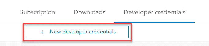

  1. Select the “Developer credentials” tab and click the “New developer credentials” button.

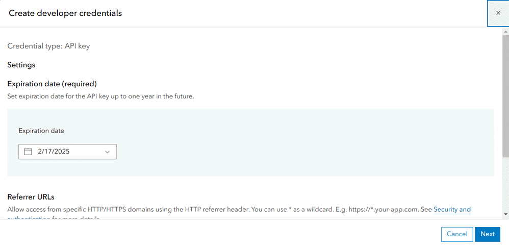

  2. The "Create developer credentials" pop-up window will appear. In this window set the expiration date and optionally the referrer URLs, then click the “next” button.

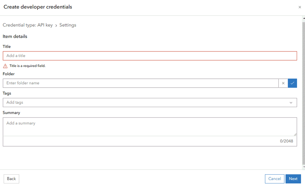

  3. Give the API key a unique title (e.g., based on the user or group that will be assigned the API key) and optionally fill out the other settings, then click the “next” button.

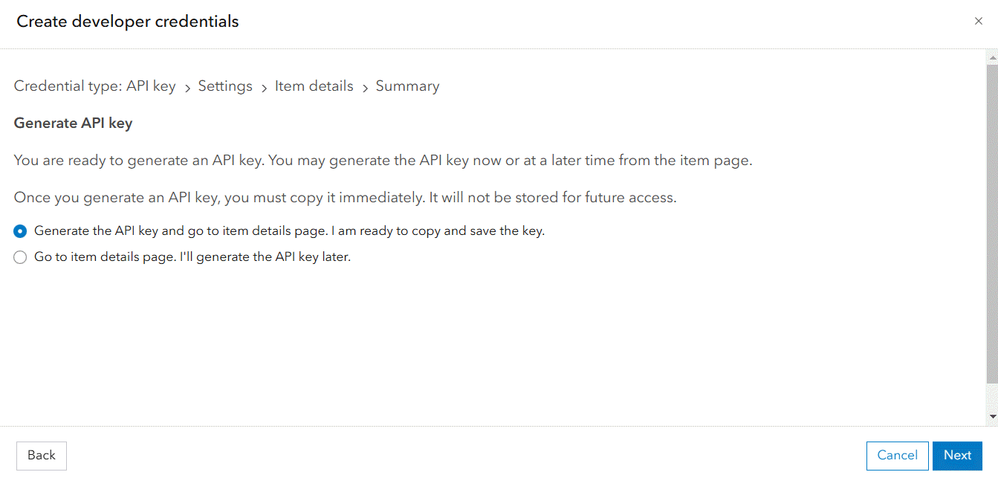

  5. An option will be provided to generate the API key now or later. Select an option and click the "next" button.
    Note: Once the API key is generated, it must be copied immediately to a secure location, given that it is not stored for future access. Following the API key security best practices will help keep the API key secure.

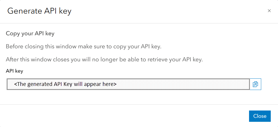

  6. If the option to generate the API key “now” was selected, the API key will appear in a new pop-up window. This API key is used to authorize GeoAnalytics Engine. As noted in step 5 above, following the security best practices will help keep the API key secure.generate_api_key_popup.png

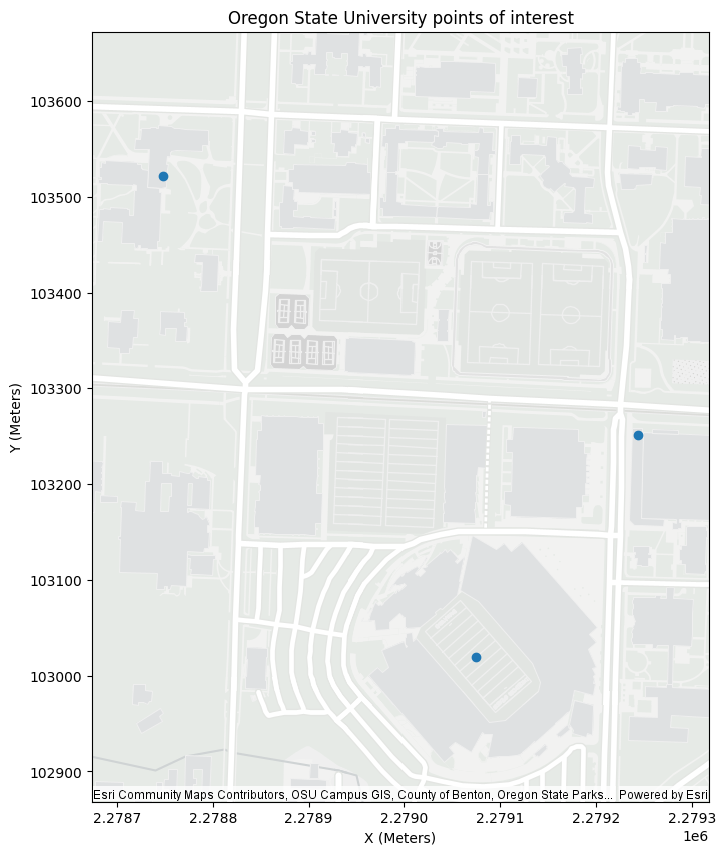

# Plot the DataFrame (Note: `%matplotlib inline` might be needed to make the plot appear)
df_plot = df.st.plot(basemap="light", xmargin=0.15, ymargin=0.3, figsize=(10,10));
df_plot.set_title("Oregon State University points of interest")
df_plot.set_xlabel("X (Meters)")
df_plot.set_ylabel("Y (Meters)");
