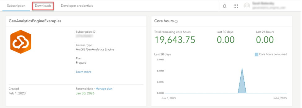

If you are working with a GeoAnalytics Engine Connected license, you will download the relevant files via the GeoAnalytics Engine dashboard
Log into the dashboard with your user credentials for GeoAnalytics Engine.  Note that these are different than your ArcGIS Online user credentials.
From the dashboard, click on the Downloads tab.

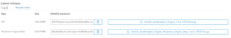

From the Downloads tab, you will have access to the latest releases. There are two files – both are tar.gz files and you will need to extract the files from the *.tar.gz file. You may be able to simply right click on the downloaded file and select “Extract All…” to extract the GeoAnalytics Engine files.
  • API – the core files for using GeoAnalytics Engine.  Details on what is included can be found in the installation documentation
  • Projection Engine Data (optional) – an optional set of data for the Projection Engine. If you are working with map projections or coordinate systems that aren’t included in the basic set in GeoAnalytics Engine, you will want these additional files to facilitate coordinate system transformations.  More information about the projection engine can be found in the help documentation on coordinate systems and transformations

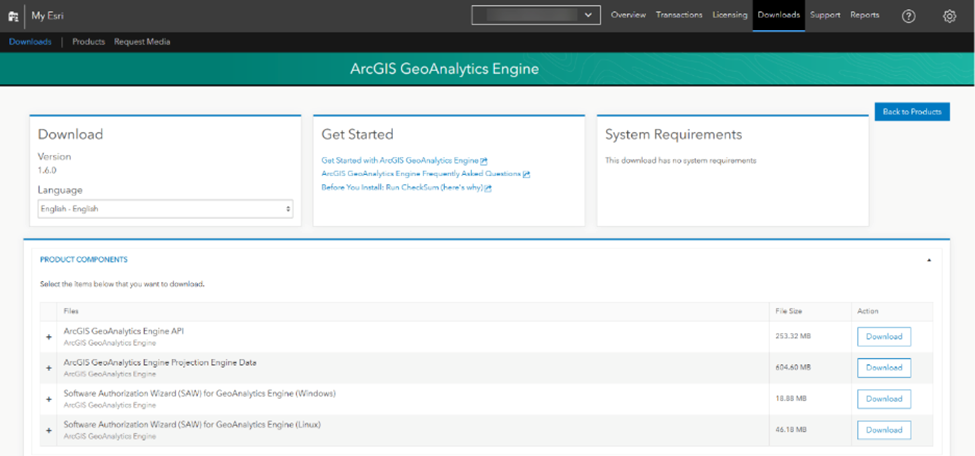

For a disconnected license, you will access the files for GeoAnalytics Engine using My Esri. From the My Esri home page, click on the Downloads tab and choose "All Products and Versions". Under "All Other Products" find ArcGIS GeoAnalytics Engine and click the "View Downloads" button. There are four downloads available for the latest release.
  • Software Authorization Wizard (SAW) for GeoAnalytics Engine (Microsoft Windows) – A Windows application for activating your disconnected license.
  • Software Authorization Wizard (SAW) for GeoAnalytics Engine (Linux) – A Linux application for activating your disconnected license.

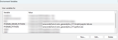

There are several environment variables that you will need to set so that they can be found when starting up your Spark environment.  The GeoAnalytics Engine developer documentation has details on setting these up individually from a command prompt.  You can also do this with the Microsoft Windows GUI for editing system environment variables (via the Control Panel).
Because I occasionally switch between Spark versions, and don’t want all of my settings permanently in my Path, I have opted to set most of my environment variable (related to Java, Spark, and Hadoop) as part of a startup script.  However, there are two items that I do add to my Path: PYSPARK_PYTHON and PYSPARK_DRIVER_PYTHON.  I add these to my Path since the PySpark driver will be the same regardless of what version of Spark I’m using, and because I want to use Jupyter notebooks to interact with GeoAnalytics Engine.
When I set those as user variables, my Environment Variables look like this – and note that I am pointing specifically to the python.exe and jupyter-lab.exe in my virtual environment for GeoAnalytics Engine (venv_geoanalytics_311).

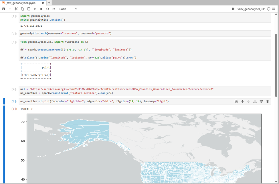

Now that this is all put together, I can just run my batch file from the command prompt.  When I run the script it should start up Spark, load the GeoAnalytics Engine jars, and open a Jupyter notebook (based on the Path variable for PYSPARK_DRIVER_PYTHON).
Then I can confirm that everything works by trying some simple code in my Jupyter notebook:
