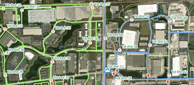

How you map CP assets defines what you can do with this critical data. If all you want is a pretty map, you just need to place a bunch of points.
With a little more planning and editing, you can connect these points to the metallic pipes and assets they protect. This enables the creation of CP Zones.

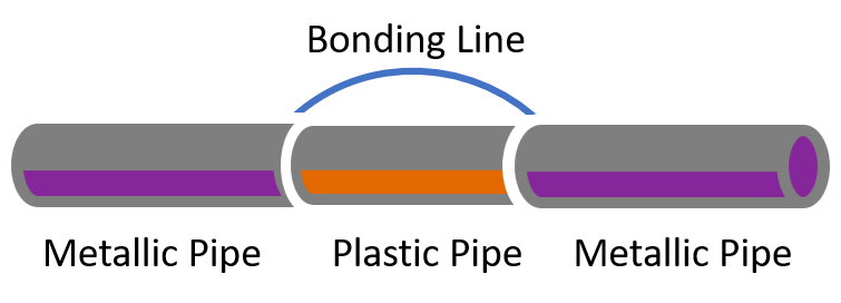

Management of Bonding Lines
Bonding lines are the wires used to extend the electrical connection of the cathodic protection system. They are used to span pipeline assets that are insulated or natively non-conductive.
Example of Bonding Wire Spanning Plastic Pipe Segment

  • Scenario 3: Plastic Pipe Spanned by Bonding Line
    • Asset Type                         = Plastic PE
    • Bonded Insulated            = Bonded
    • CP Traceability                 = Traceable

Building the CP Zone
With the CP assets now mapped and organized within the Utility and Pipeline Data Model (UPDM), and the CPTraceability data field now populated, we can build the CP Zones.
The software's logic for determining the extent of a CP zone is very simple. Start from a designated CP Test Point Station(s), then trace across the connected CP and pipe system assets, checking each asset for its CPTraceability value. If the ' 'asset's CPTraceability value is "Traceable", then continue the connected trace. When the connected trace finds an asset with a CPTraceability value set to "Not Traceable" the trace stops.
When the trace stops, the software will then gather the selected primary pipe segments to create the geometry for the CP Zone. This is stored in the Pipeline Subnet Line featureclass. Additionally, all assets selected by the trace will have the name of the CP zone written on the asset's record.

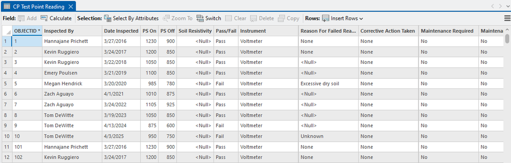

Supporting Cathodic Protection inspections is also defined within UPDM. Tables related to the PipelineDevice featureclass are intended to store the inspections captured in the field by CP technicians using an ArcGIS mobile application.
These related tables to the CP Test Station and CP Rectifier features store all the inspections. This provides a single, intuitive source of truth for CP technicians.

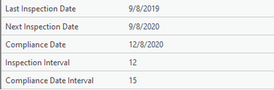

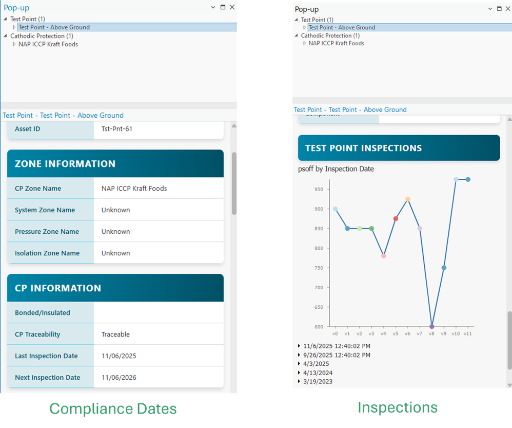

Managing Compliance Dates
Managing compliance dates is the last component of full cathodic protection management. It requires mapping the assets and managing inspections in ArcGIS.
Attribute rules embedded in UPDM provide the automation and logic to manage the Last Inspection Date, Next Inspection Date, and Compliance Date for each cyclically inspected CP asset.
These date fields will be part of the PipelineDevice featureclass schema in UPDM when added as part of the Spring 2026 update.
Now, when a mapper adds a new CP Test Station, the compliance dates are automatically tabulated, and the inspection date fields are automatically populated.
When the field technician performs a CP inspection, submitting the field inspection to ArcGIS automatically triggers attribute rules to update the asset's Last Inspection Date, Next Inspection Date, and Compliance Date.
