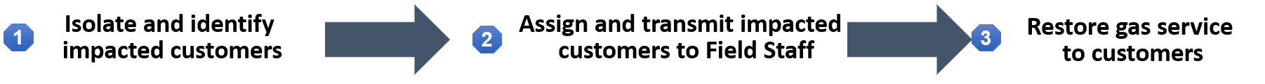

Prepping Data for the Field
The first step in accomplishing this is to use a geoprocessing model to upload the selected data and append it to existing feature layers. These feature layers can be hosted in ArcGIS Online, or they can be hosted on an ArcGIS Enterprise Portal.
In addition to appending the customer meters impacted, the isolating devices, pinch locations, and the extent area, a geoprocessing model provides the opportunity to prepare the data for field use.  Here is a list of commonly added attributes and their purpose:
  • TRACEID to customer meters point features, pinch location point features, isolating valves point features, and extent area polygons. This will allow all data associated with the outage event to have a common ID.
  • RELIGHTSTATUS to the customer meters point features. This will allow gas field staff to track each meter/customer point feature through their gas light cycle (unassigned, assigned, out, off, relit, no entry,). Default value is “unassigned”.
  • TIMEOUT to the customer meters point features. This will allow gas field staff to document the date and time when the meter lost service.
  • TIMEOFF to the customer meters point features. This will allow gas field staff to document the date and time when the meter was turned off.
  • TIMERELIT to the customer meters point features. This will allow gas field staff to document the date and time when the meter was turned back on.
  • NUMBEROFPASSES to the customer meters point features. This will allow gas field staff to document the number of attempts to gain access to the premise to relight the gas appliances.
  • OUTAGETYPE to the outage event area polygon features. This will allow office staff to identify the type of event which caused the gas outage.
The geoprocessing model when run will take impacted customer meters and upload them to the feature layers.  A minute or two after the model has finished running, the data is available for gas operations staff. No more waiting for the horse-drawn buggy to arrive with the information.
