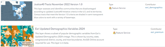

Equity & Demographic Data
To ensure our decisions are equitable, we need to understand the communities served by the gas distribution network. The ArcGIS Living Atlas provides a wealth of authoritative data layers on hundreds of topics. For this analysis we will use the following layers:
  • Justice40 Tracts: This layer assesses and identifies communities that are disadvantaged according to updated Justice40 Initiative criteria in the U.S. and its territories.
Environmental Factors

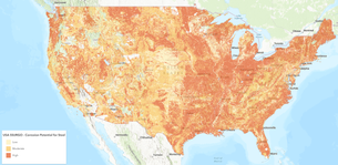

Geological and environmental considerations can significantly impact infrastructure longevity. We'll incorporate data on soil corrosion potential from the ArcGIS Living Atlas to round out our analysis example.

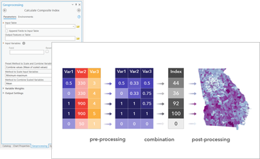

  5. Create an Index: MeganHendrick_3-1734550797518.pngThe Calculate Composite Index tool (available in ArcGIS Pro 3.2+) combines multiple variables into a single index, allowing us to rank each distribution main based on our chosen characteristics. Changing the weight of each variable allows for certain characteristics to be prioritized in the index. We will use the calculate composite index tool on our analysis layer, using our new fields (Pipe Age, Corrosive Soil, Leak History, Population Density, and Justice40 Status).

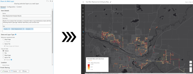

  6. Visualize the Results: Now we have a layer showing the most vulnerable gas mains by material, with each asset including a score from the composite index tool. By publishing the results to a web map, we can configure styles and symbology for clear visualization & easy sharing of the results. MeganHendrick_4-1734550797519.png

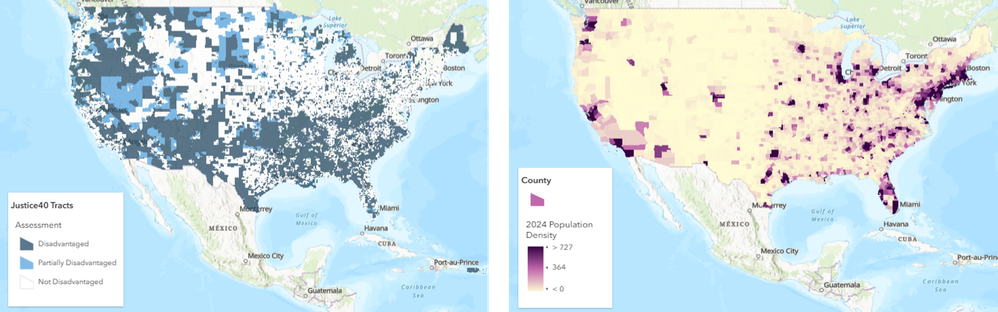

  7. Add Demographic & Equity Data: Next we'll add layers from the Living Atlas to our web map to visualize key demographic variables and disadvantaged communities. MeganHendrick_5-1734550797521.png

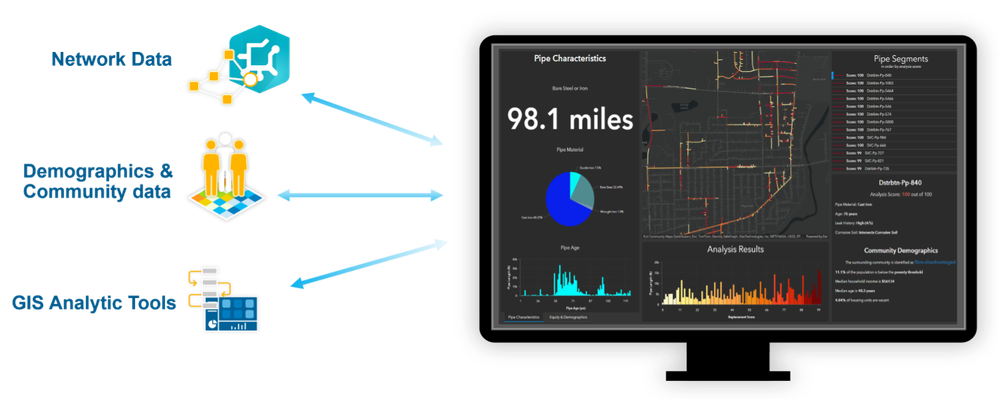

  9. Create an Interactive Dashboard: MeganHendrick_7-1734550797522.pngThe final step is to highlight our results with an interactive and concise dashboard, allowing stakeholders to understand how network information and community insights work together to inform stronger decision-making. Users can explore the results to identify where vulnerable assets exist in the community, and where the community itself may be more vulnerable.
