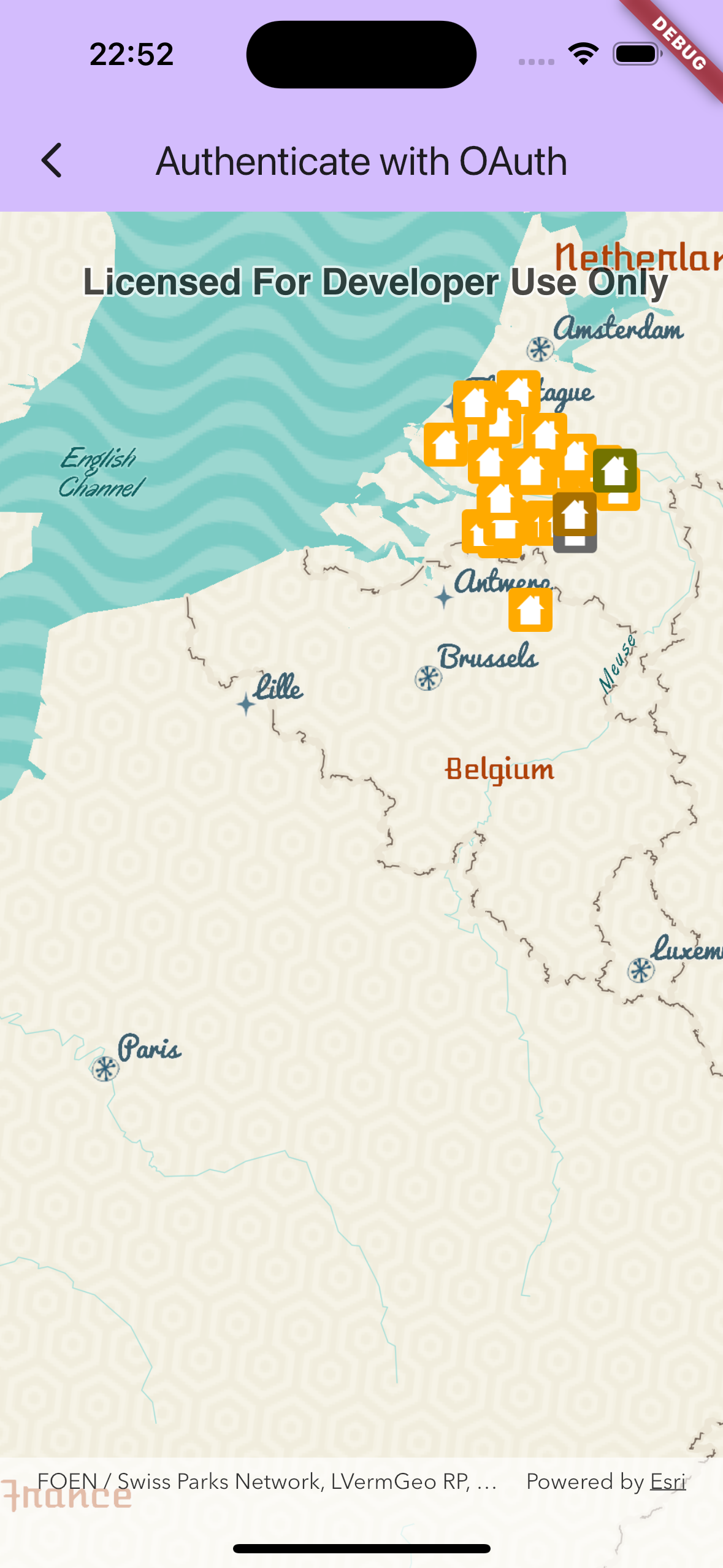

I have created a map by loading webmap containing secured traffic layer (item id: 'e5039444ef3c48b8a8fdc9227f9be7c1', same as in samples). Then, I've added simple feature layer created via url to 'map.oprationalLayers' list. This feature layer comes from samples also.
I have OAuth set up (I can verify that it works correctly). Also, I don't set 'ArcGISEnvironment.apiKey' variable.
I expect that auth challenge is raised, webmap is fully loaded, and feature layer is loaded also . Nevertheless, auth challenge is not triggered, I see only basemap (without traffic layer) and correctly loaded feature layer:

I was able to figure out how to make this work. Basically, wait for the map to load before adding the operational layer. You can do this many different ways. One way is to call "await map.load()" before adding the operational layer. Another way is to use ".then()" like this:
map.load().then((_) => map.operationalLayers.add(serviceFeatureLayer));
We either approach, the important thing is that the OAuth login is completed before adding the feature layers.

Thanks, awaiting map loading fixed an issue.
