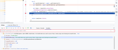

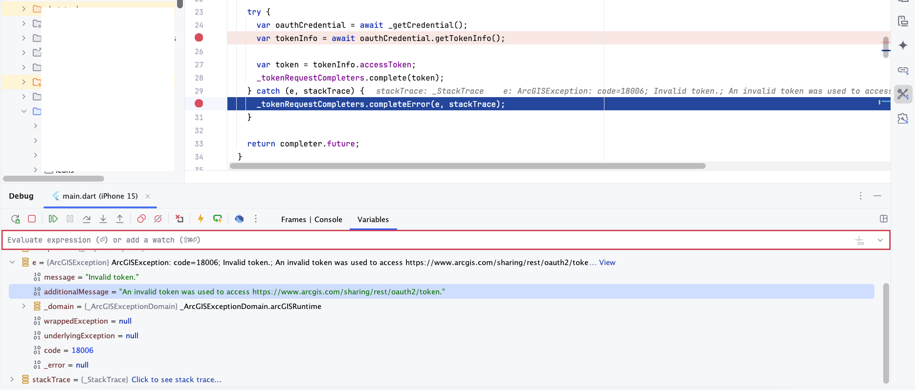

2. Close app and launch it with persistence ENABLED. It will fail with an exception:
ArcGISException: code=18006; Invalid token.; An invalid token was used to access https://www.arcgis.com/sharing/rest/oauth2/token.

Exception is thrown by 'oauthCredential.getTokenInfo()' call inside my internal class responsible for extracting OAuth2 token for my own server requests. Not sure why this is happening. I use all methods from SDK. Possibly, there is a call to 'oauth2/token' endpoint with outdated token, and server just returns an error instead of new token? Could you please advice something on this?
