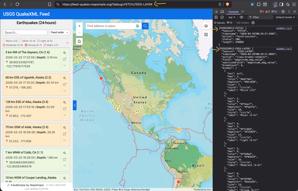

Here's another one using FeedSimple, a live data feed widget pulling USGS earthquake data:
https://feed-quakes.mapsimple.org/?debug=FETCH,FEED-LAYER
This one shows the data fetch cycle and the feed layer creation. Same logger, different widget, same clean output. That's the kind of visibility you get.
